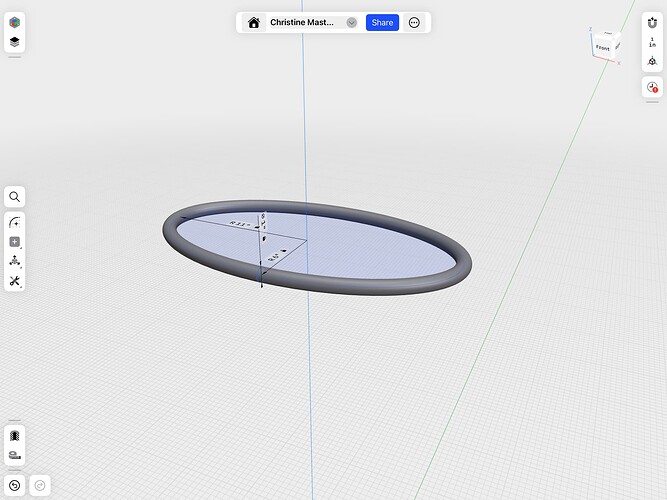

I am creating a mast with a rope around the mast I can make the sweep, but not create the offset with continuation of rope around the mast. The rope is 1” mast is about 10” on major and 6” on minor dimensions
Like this?
Yes that is perfect

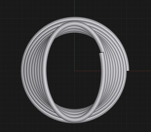

This is simple way.
A couple of other variants came into my mine also.
And if you like me and don’t like to use move tool this is another way
Another variant

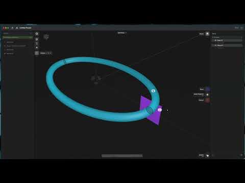

Revolve
Trim the spring
Use edge to sweep
How did you trim it?
Nevermind I get it. Didn’t see good from the phone :slight_smile: Interesting approach BTW.
