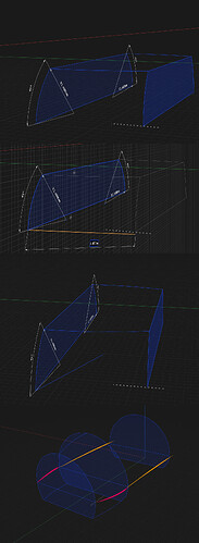

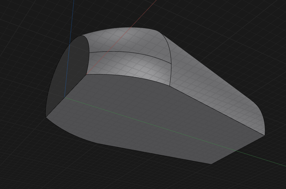

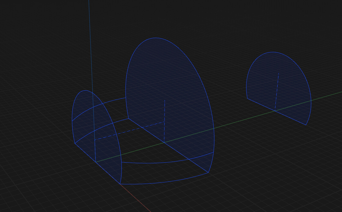

I’m trying to do a loft between my curved sketches and i cannot figure out how to do a spline against the curved portion and it keeps going on the wrong axis. I indicated in pink the curve I want to achieve in the final pic, orange is a just a straight line for reference.
you need to create a cros-section sketch plane and draw your curve on it, matching the purple intersection points.
you need to draw a construction line for the intermediate points, so that you can snap your spline with the coincidence tool

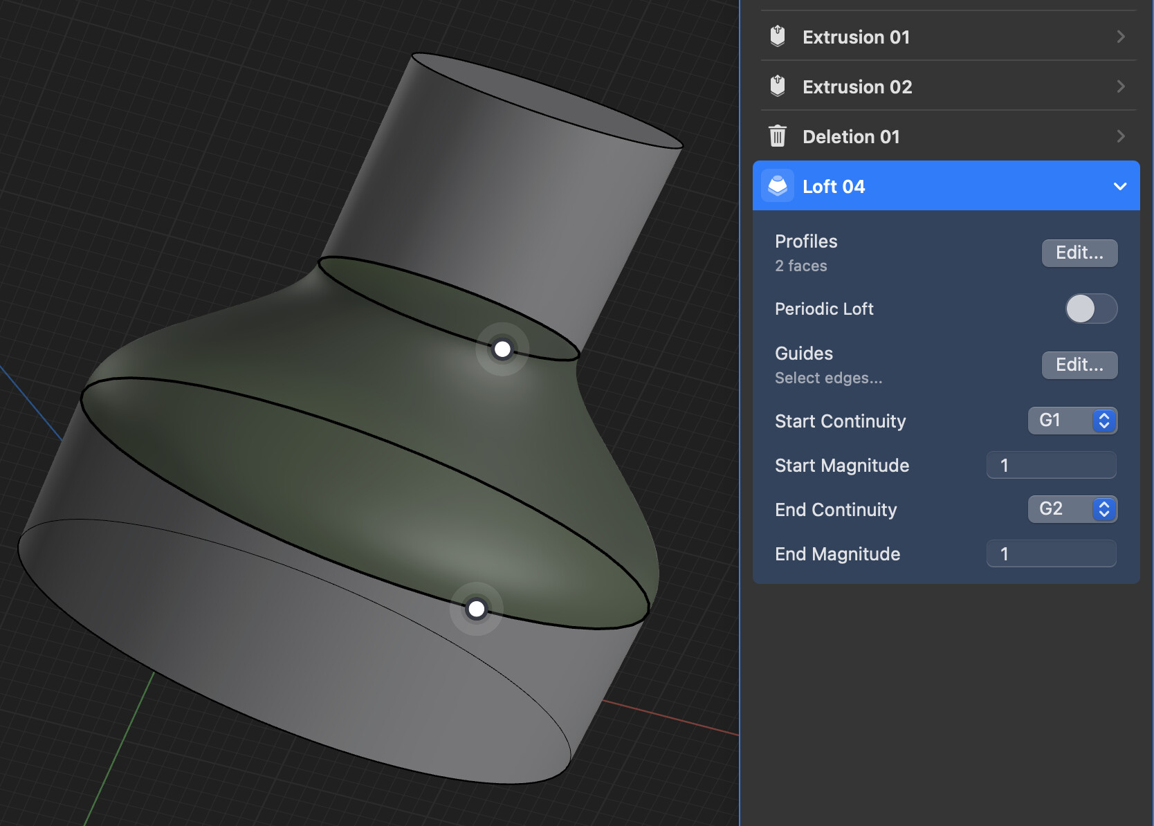

You can use G1 continuity to get the result.
G1 continuity:
Guides:
Yes!
I often use it in my bottle or other designs. This is very practical and always guarantees continuity between the elements.
