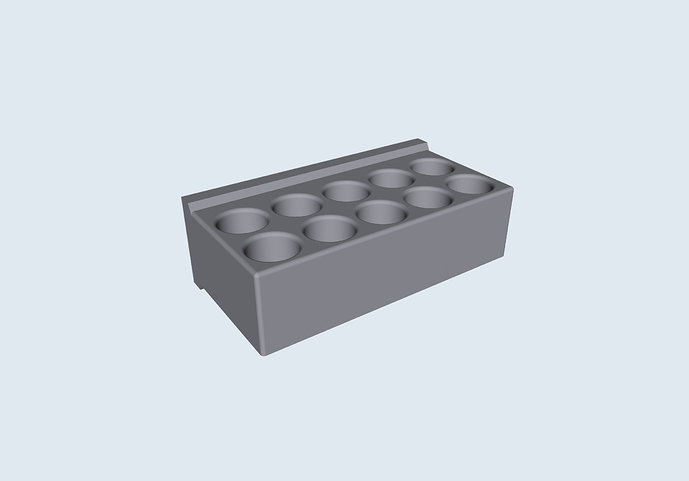

Would be nice to have a way to copy an object, but multiple copies in one go, and specify the distance between them etc.
ie, where I want something like Screw holes in 10 speific places, which for circle based objects is easier with the rotate and copy, but would be nice to say 8 copies, 10 degree difference etc.
and a similar feature for non circulare objects. the ability to say replicate a hole, or replicate an object a number of times over a specified distance etc.
ie, like this object, which took me a while to ensure everything was lined up, it’s a really simple object, but for where I want to do this on something more complex it’s a bit of a mare to get them to line up.
