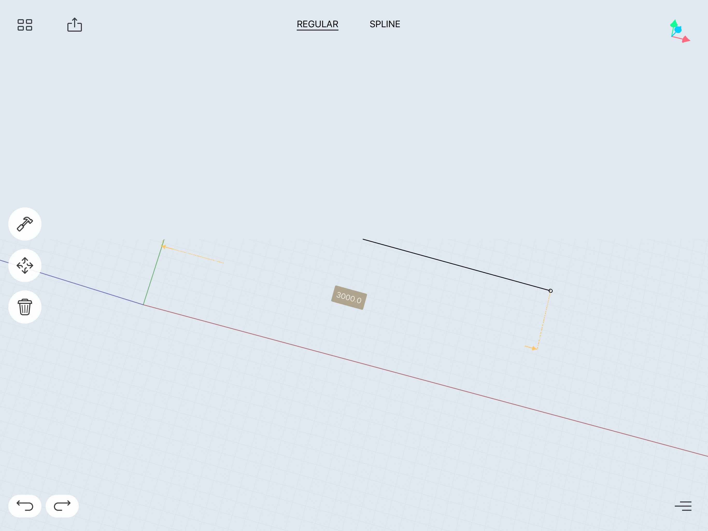

The missing measurement is probably because you created that line in spline mode, thus it is a spline and not a line, and we don’t display any measurements for splines currently. However the expected behaviour should be to create actual lines instead of splines when there are only two control points.
As far as I know, I was working in regular mode.
On the screenshot you posted, spline is underlined, that means that you are in spline mode. That’s why I thought this could be the issue, but I will look into this anyway.
How can I find out if some of them got unintentionally drawn in spline? I should be able to drag the handles if they are, right? It may have been put in that mode on accident while I was doing screenshots and posting. I remember and thought I just drew lines and circles. That would be interesting to find out if I accidentally drew a couple straight splines. Certainly a learning experience of what not to do sometimes. Is that to say that there are issues revolving splines? Or are you just showing me that the revolve and lack of measurements may not be related issues. Either way when I deleted and drew the lines again the revolve worked.
I checked the lines and they do not behave as splines. In retrospect I was considering that when the user selects a line that is a spline the mode would possibly highlight or something to show what you are working with.
