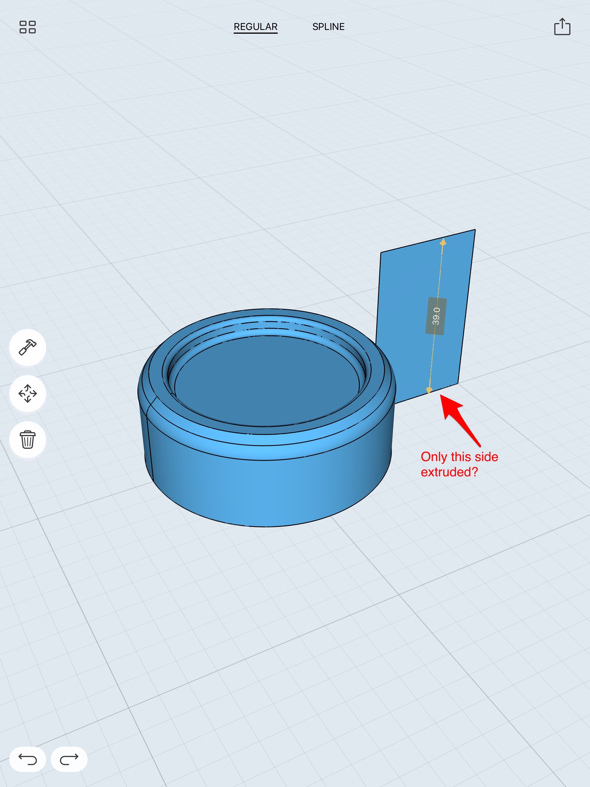

  • [ ] Drawing a line on the plane below a solid object loses its dark color. Trying to extrude this line through the object fails, only the darker line outside the object extrudes. See the pic.
Hmm, weird, I will take a look at this.
