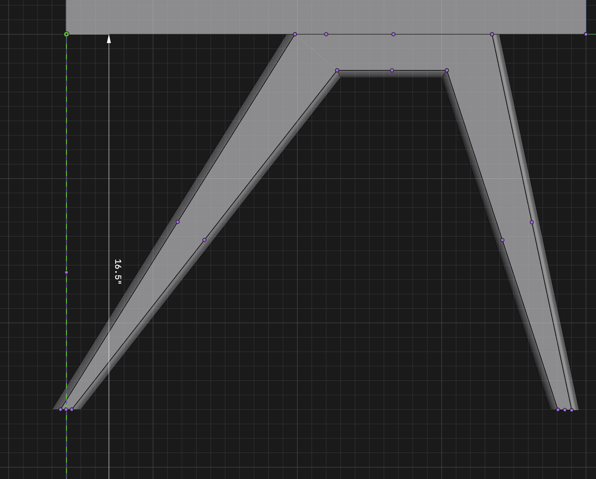

Hello,
Thanks in advance for your help. I sketched these legs, extruded them into bodies, and then afterwords realized the legs extended beyond the face of the drawer (see picture). I would like to them to be flush with the drawer (vertical line) but want to leave the rest of the legs the same. In other words, I want to change the length and angles of the front leg without affecting the rail and back leg. I’m new to Shapr3d and I don’t want to redraw these legs and start over.
Go back to the sketch and simply move what you need to the new location. It’s hard to be more specific because I don’t know exactly how you created the shape.
