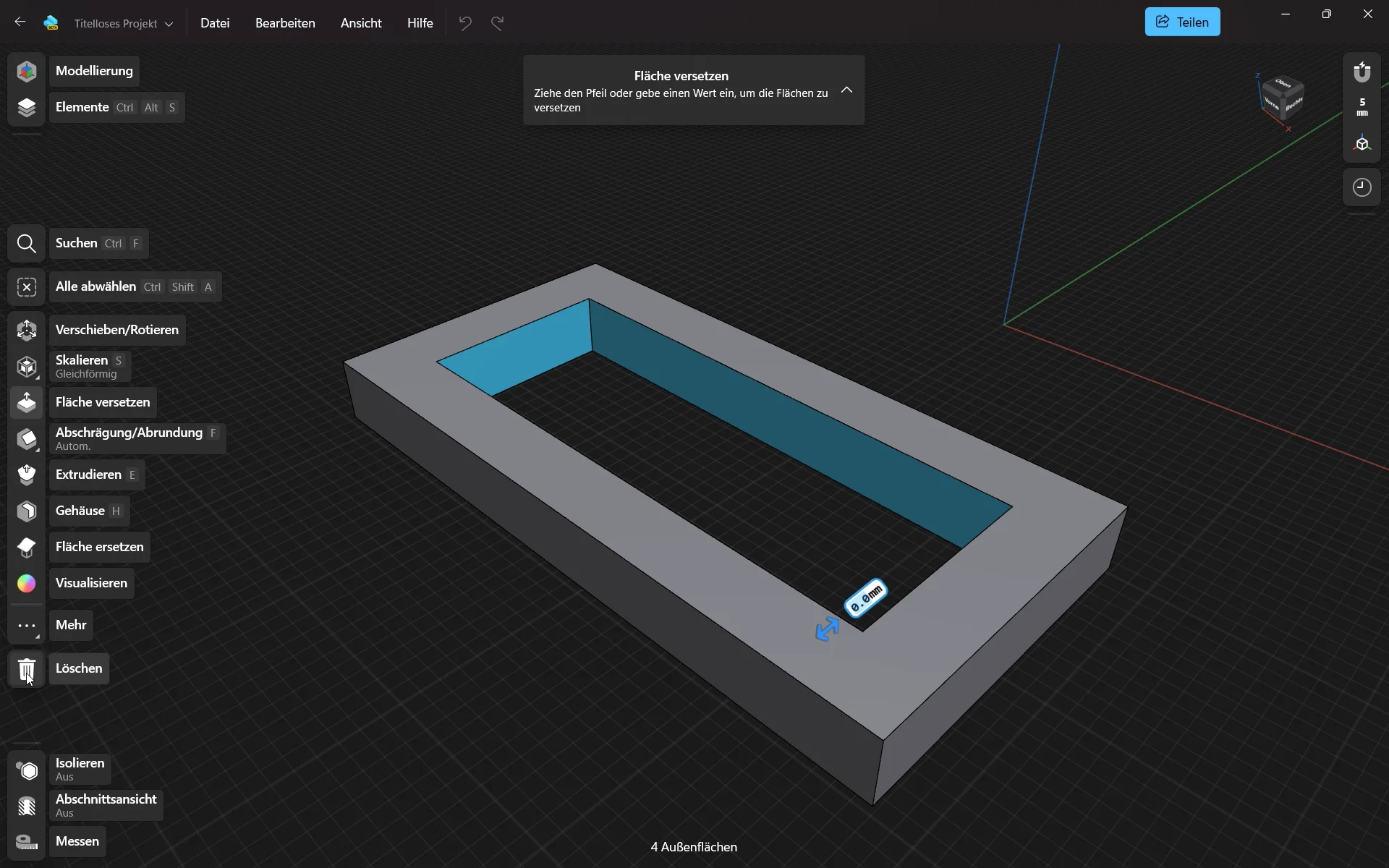

Here is an example of where I am attempting to fill in a hallow rectangle. In Fusion, I would simply click on my face, choose extrude, and then choose the target fact to extrude to. But in Shapr, it seems I need to measure the exact distance that I want to extrude and then enter that value in. This will be problematic with parametric modeling as if I change the length of the box, the extrusion will not match

You didn’t break it, the first operation is an extrusion. De second one is offset face. Only extrude snaps. Face selection defaults to offset, not extrude.

For faces, the default operation is Offset face, not Extrude. When you do the second operation, it’s an Offset face.
I understand that this might be confusing, we are looking into solving this issue.
Ah, I see. Could we put in a request to allow for choosing the destination object / face with a second click instead of a drag and drop? For the reasons I mentioned previously about how it might not be as easy to locate it all the time in one motion
We’ll consider it, thanks for the feedback. Currently you can also select the closing object from the history panel if dragging is inconvenient.

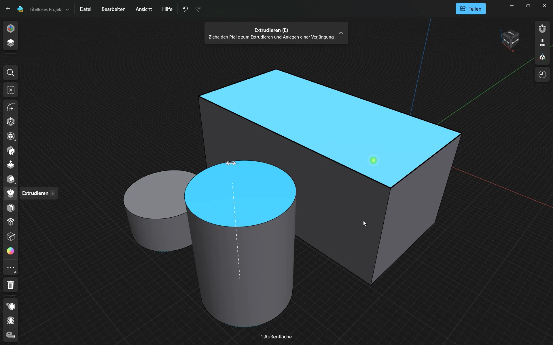

Hello Istvan,
Could you take a look to the patterns into this. When I tried to extrude it works strange and gives a total different result:
