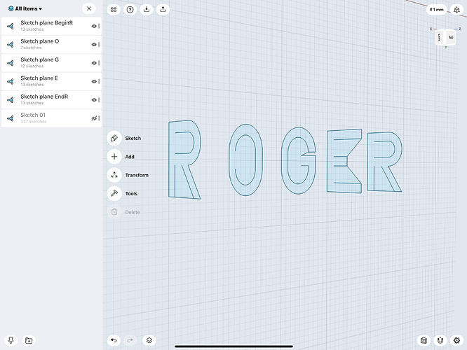

I’ve drawn out some letters (my name) and copied them in any arc and it won’t allow me to loft them. I’ve taken just one of the letters and copied it straight up one time and it won’t let me loft it. I’ve tried other shapes and they loft just fine but no R.O.G.E.R. Why is that?

There are a caveats to consider when Lofting, including but possibly not limited to:
  1. All Sketches MUST be Closed Sketches, in 3D view if they do not fill with a Colour then they are NOT Closed.
  2. Sketches that contain areas that would create ‘hollows/spaces’ within the Loft cannot be included.
  3. Widely differing shapes like the R and O, shown modified in the following in an attempt to demonstrate some of the limitations.
Please bear in mind that these ‘modifications’ are only a few of many possibilities:
Regarding the apparent problem with, e.g., Lofting R to R, within the caveats stated above this will function as shown:
Double Tapping using your Finger(s) on the end face, of the Body created, will enable the reinstatement of a previously deleted Line to recreate the required aperture:
Selecting this Closed Sketch it can be ‘pushed through’ by using the Double Arrow:
Of course it would be much simpler to 'Pull Ou’t the Closed Sketch of the R.
Experimenting and searching for, in this case, Loft or Lofting is the best route to take.

I wasn’t able to reproduce the “Double tapping” to recreate a deleted line but was able to work around. I loft the center of the R’s and O then hid the body. Deleted a portion of each sketch and loft the outer body. Selected the outer body and subtracted the inner from.
@Rogerlj
When using the Double Tapping method to ‘focus’ a Face it is essential to ensure that it is big enough, or Zoomed In on to make it big enough, to accept the ‘tapping finger’. This is not to say that the Face needs to be made over large. Tapping success will cause the Face to position itself square on to your view and the Grid will become visible. Tapping failure will result in very little happening if anything happens at all.
Simply try the tapping process a few times before Zooming, with a little practice it will possible to determine Face area(s) that respond to individuals tapping skills.
The following indicates that ‘Push or Pull’ is effective to create Bodies directly from various Lettering Sketches. Other methods [Transform > Rotate around axis] to create ‘wedge’ shaped [bottom edge pivot point] to gentle curves from a suitably positioned Axis or [Tools > Sweep] shown swept along a Spline.
Transform > Rotate around axis requires the Tools > Subtract that you found useful while Tools > Sweep is directly effective with straightforward Lettering Sketches:
