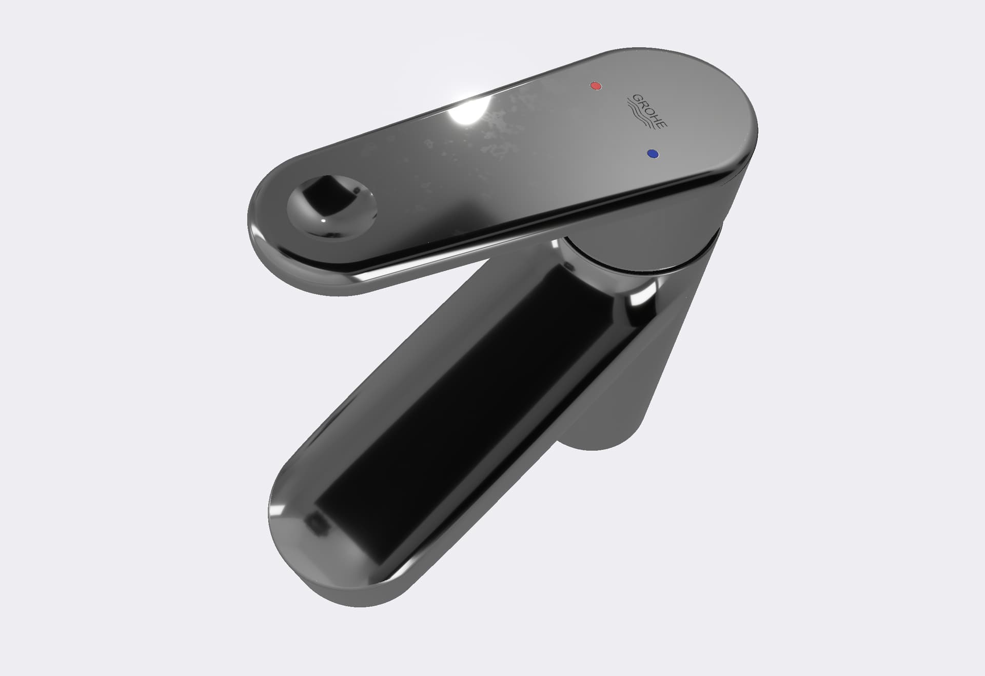

As it was a rainy Sunday, I spend a few hours modeling a tap just to try materials.
Looks great! I chose polished aluminium to get the real polish look instead of the chrome.
Real time rendering is very fluid on my MacBook air m1 on this simple design.
Wow, really nice! :heart_eyes:
