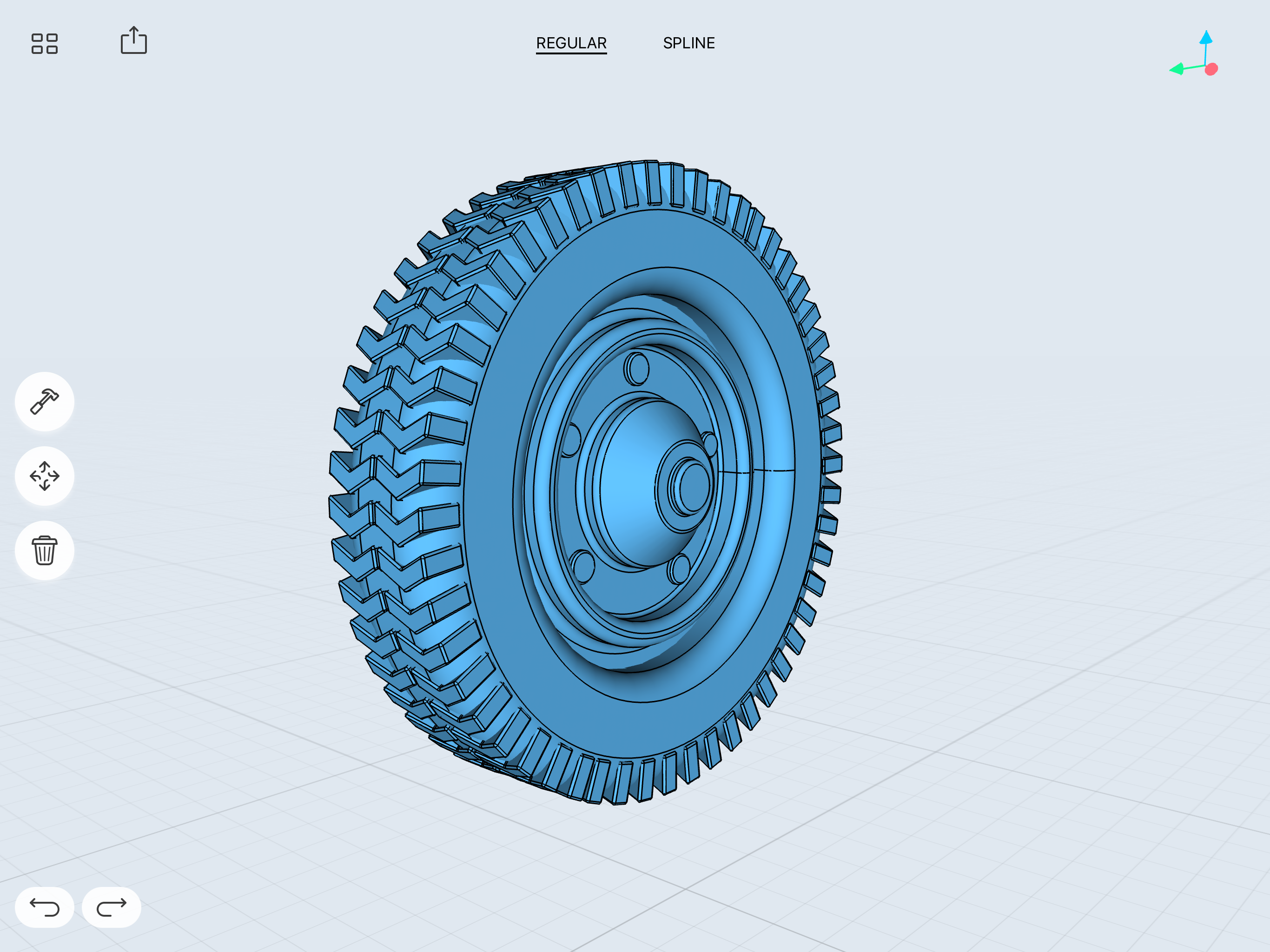

A real test for the copy function - I started to make this wheel last week but decided to wait until copy was available before finishing the tread on the tyre. I started with two parts of the tread, one at the top of the tyre and one directly opposite at the bottom of the tyre. I then selected both and did a rotation with copy switched on. Repeated this several times to get the full tyre - very simple and fast! Only trouble is, I seem to have created an enormous file and I doubt that I could export this as an stl. Never mind, it looks great as it is. Andy
Wow, I would say it is reasonable that you waited until we have the copy paste :slightly_smiling: Cool.
