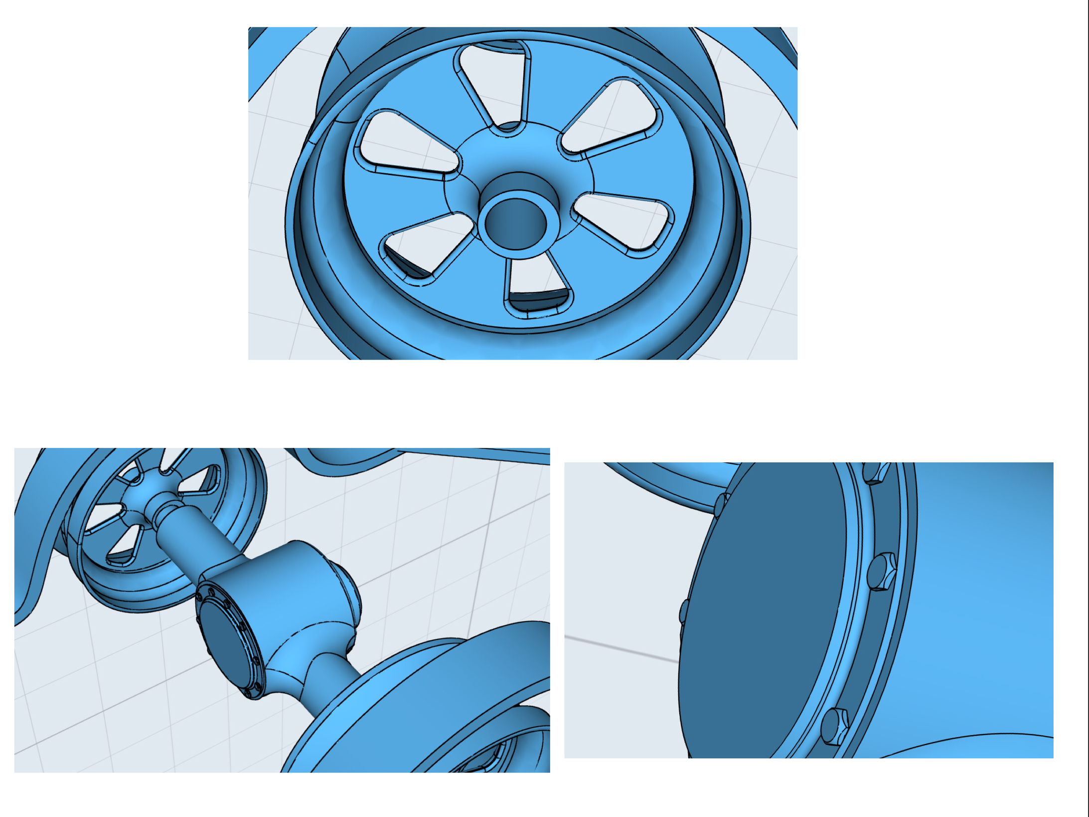

Wow, that’s really cool! Can you give a closer shot of the rims?
Adding more parts to it. Working on a rear axle. I don’t know how to centre a new solid on an existing one to union with it. I’m just doing it by eye now, which is why you can see the hole in the rim is not on centre. If I have an existing cylinder and want to move another one to the same centreline, how do I do that?

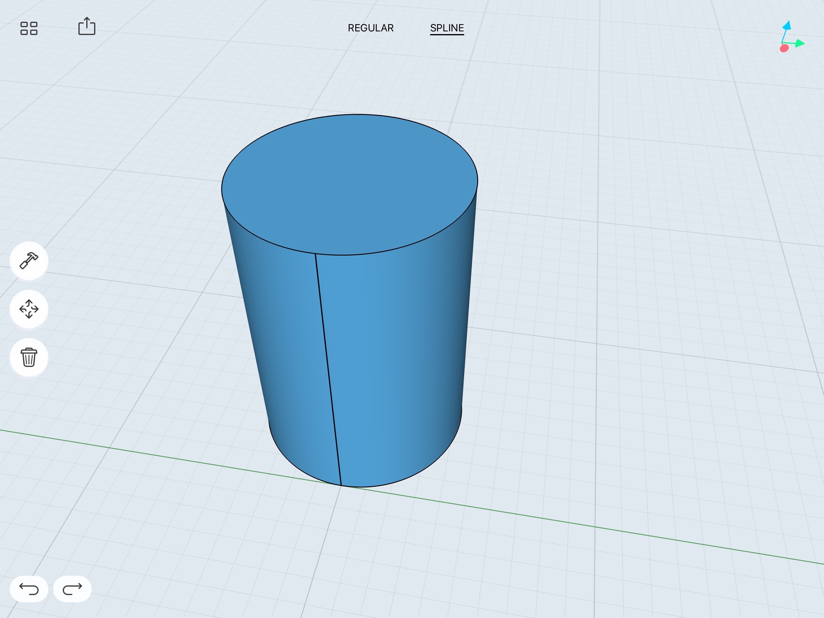

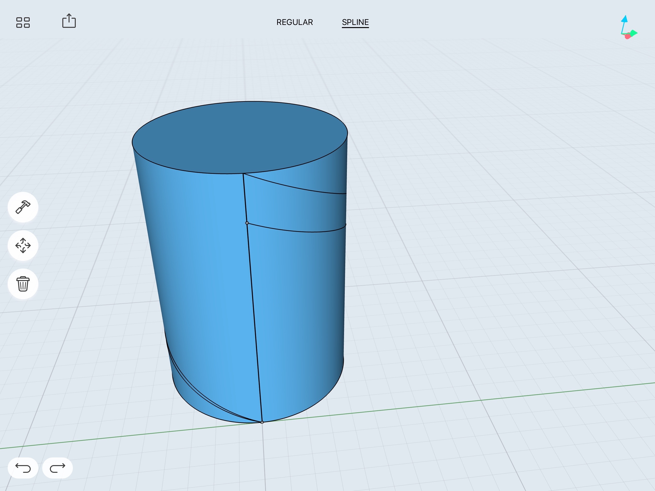

Result of testing :wink:
Wow - how did you do that?
By sketching splines on a cylinder and then pulling out the resulting faces.
You make it sound easy!
It is! :slightly_smiling: I can give you screenshots of the steps if you are interested

Yes please - that would be great.
Here are the steps, let me know if something is not clear.
