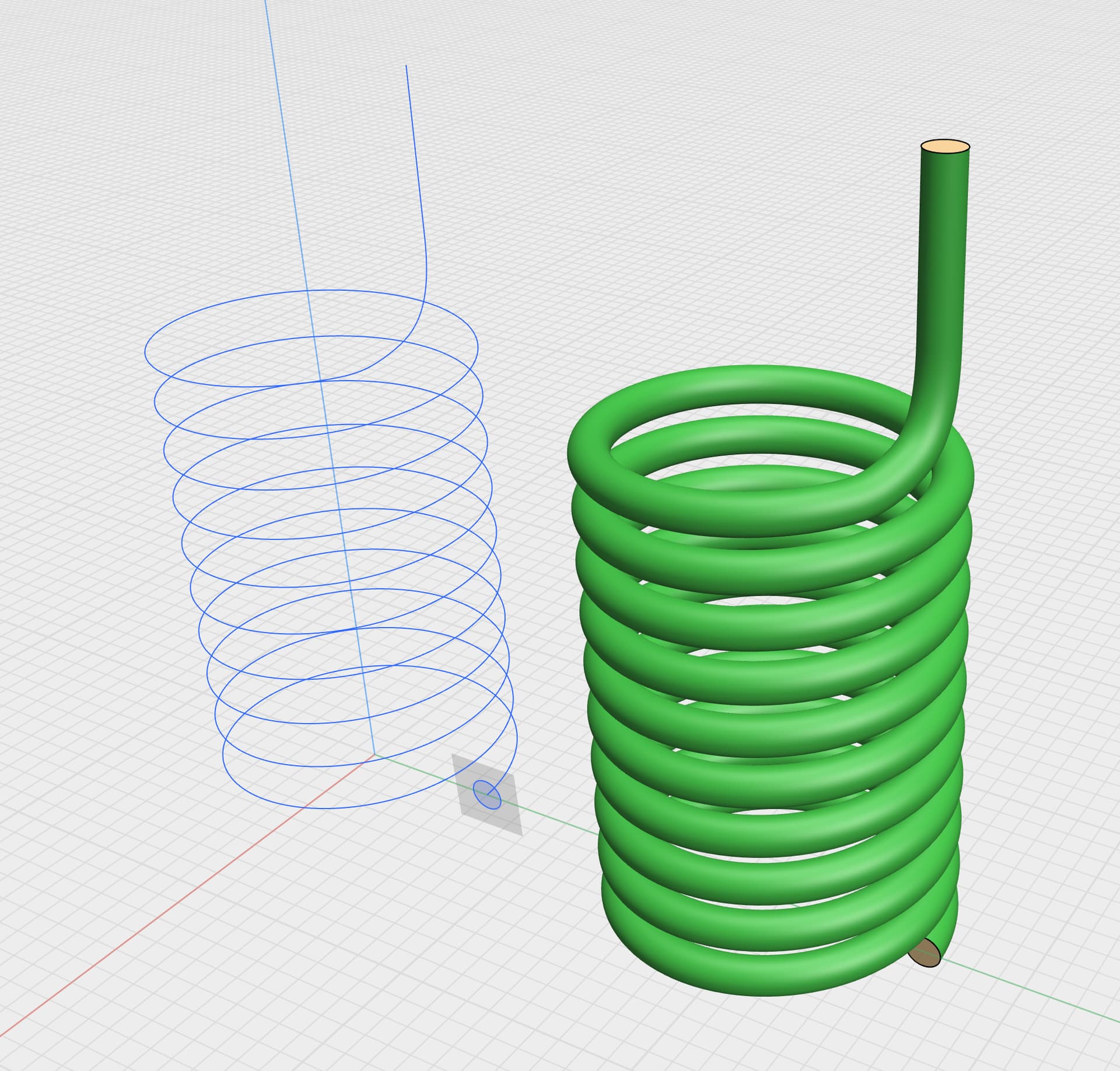

Spring design
here
Sorry for the spring design :grin:
An other question;
How to extract this 3D curve obtain by Revolve ?
Thanks

Not bad, but the issues we’re trying to eliminate here are still present in your version.

I have. As far as I know you can’t extract a line, you have to make closed sketch for extrusion. So only way I know is Sweep.
Or maybe I understand your question incorrectly.
Unfortunately, this approach has the same issue the topic starter was trying to avoid.
Ok I see what you are looking for and you found it but at the zoom level that is beyond level of the OP’s version which looked more like a flaw.
Also upload your shapr file as well, its easier to spot with the Zebra, also wana try something.
That’s why I said “not bad” :slight_smile:
About the zoom level, I can see it even without zooming I zoomed for screenshot so everyone can easily see there is the problem.
I can upload my file but not sure you’ll be able to open it. And about zebra it shows not every problem that can be seen on render with shiny surface.
Spring (loft).shapr.zip (260.7 KB)

Technically I don’t believe that is correct, he is creating segments of curve that is angled, if you do that now you need more and more segments to make more accurate.
You would need real 3d Curves to do that which is missing feature.
Since this was a tutorial I choose some other methods but realistically I would do it in another program like Rhino, because with that you really get perfect springy thing because it would be whole curve without segments to make it more accurate.
I think its good, just planes, offset, sweep,

Since we are getting nitty-gritty, Alex is little off from the top view, that one can be fixed.
Spring.shapr (176.2 KB)

This one is the best from pure sweep versions, but joint still a little bit visible
