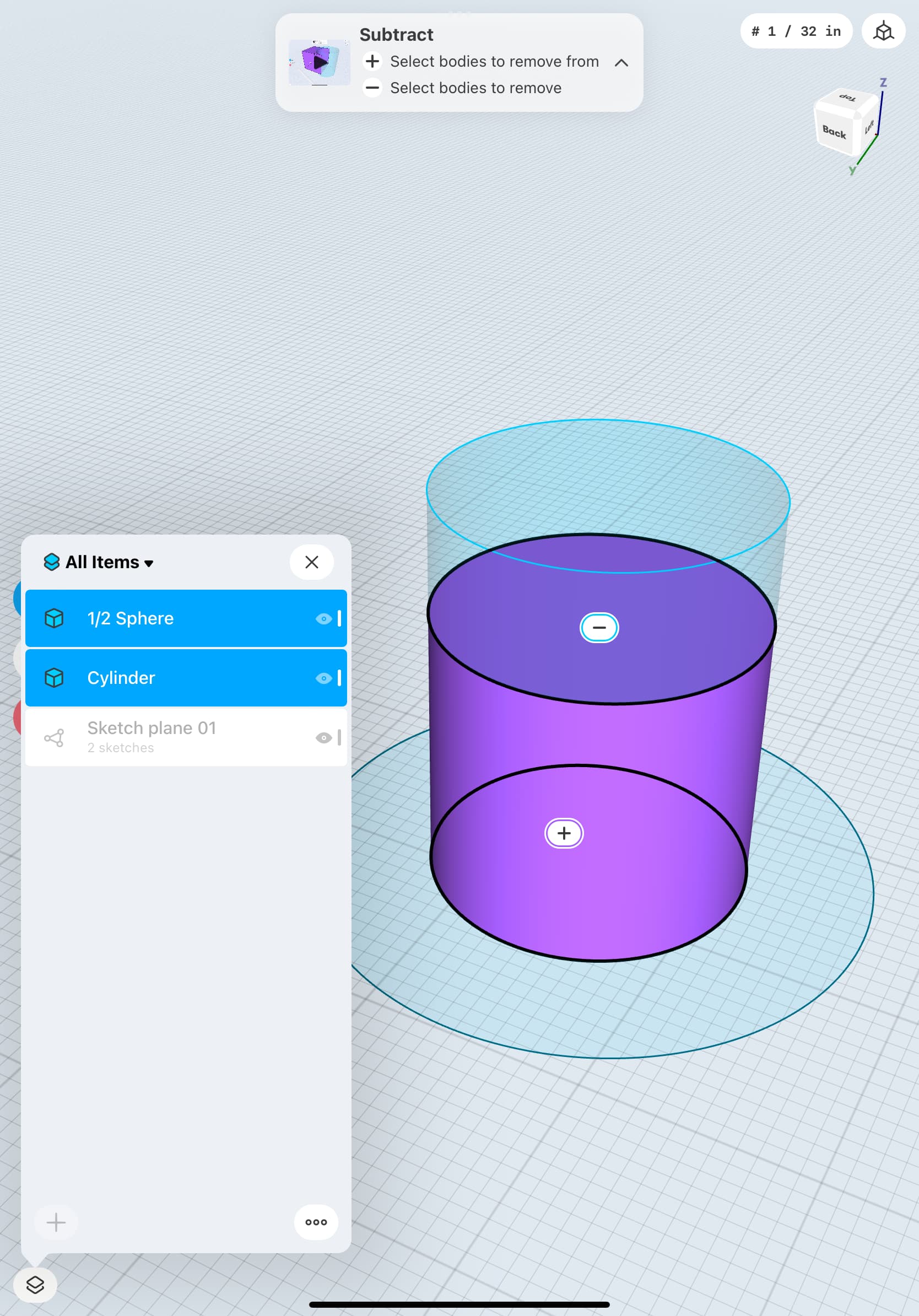

I am trying to subtract (or concave; whatever can work) a 1/2 sphere from a cylinder to create a bowl shape, but as can be seen in the picture, it is not working well for me. I would love if anyone can help.
As for the option on the subtraction tool, I chose to keep the + bodies.
EDIT: Because I can only upload 1 picture as a new user, the “1/2 Sphere” is the top cylinder in which the bottom face was convex’d into the shape of a half sphere, and is currently unseeable in the picture; it is going into the + body.

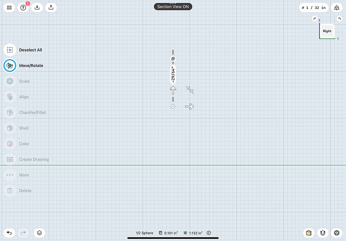

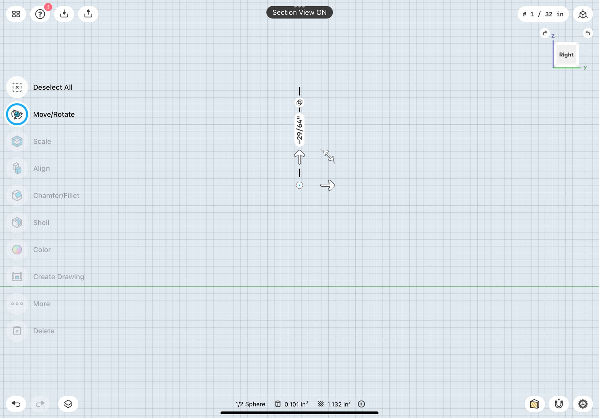

Before we trouble shoot this, tap the front or a side view, and touch the cross section to ensure it’s not working correctly. Sometimes the half sphere is difficult to see when removed.
Sorry for the late reply, busy student stuff. But the cross section view is blank, empty. I am viewing from the “right” side so without cross section, it is a rectangle (as a cylinder is if you view it from a side; big surprise). I screenshot’d the message on top to help you confirm if I had followed your troubleshooting step.
SOLUTION
After some playing around, I realized another object was created, and it contained the cylinder with a bowl. So the solution was that the subtraction was working, and I just did not understand how keeping the + body negatively impacted my perception. So for cases like this, don’t keep any original bodies lest you end up like me, frustrated for 2 days.
