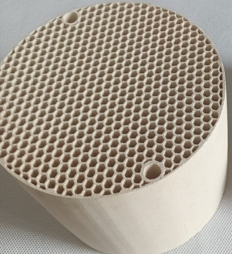

怎么画蜂窝阵列?如图!
怎么制作如图片中的蜂窝阵列?
First things first, please try speaking English here - most don’t know mandarin. And to your question, I’d recommend trying it directly in your slicer with the infill settings - for example, honeycomb as is in the image. If you need it for something else besides 3d printing, create a hexagon shape and then a pattern, then extrude the pattern.
首先,请尝试在这里说英语——大多数人不懂普通话。 对于您的问题,我建议直接在切片机中尝试填充设置——例如,如图所示的蜂窝。 如果您需要它用于3D打印以外的其他用途,请创建一个六边形,然后创建一个图案,然后挤出图案。
You can start by using the Polygon tool and setting it to 6 sides to create a regular hexagon. Then, go to Tools → Pattern, choose Linear Pattern, and set both the X and Y directions to create a honeycomb grid. Once you have a complete honeycomb plane, draw a circle on top and use the Trim tool to remove the extra hexagons outside the circle. I’m not sure what you’re making this for, but if you’re a beginner, I’d recommend using PLA.
