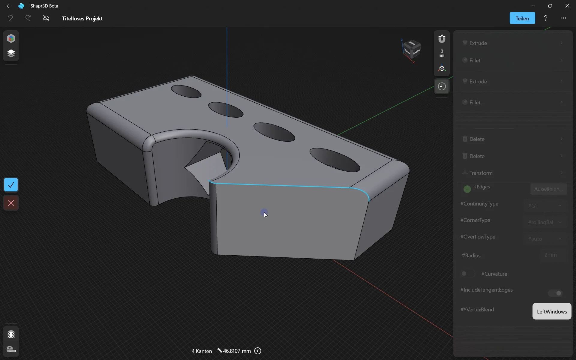

In the video you can see that I change the value of a rounding and at the same time a completely different processing is changed / deleted:

I don’t see the issue here. Those seem to be two separate fillets. When you select one, it will show up in the feature tree, and the other features will be filtered out. Then you click on the fillet feature and change the radius. What am I missing?
Could you please expand the Fillet steps before adjusting them and click on their “Edges” parameter to see which edges are involved? My hunch is that there are two separate fillets applied to the edge on the left side, and one of these operations is shared with the one on the right side, and this would allow us to check that.

If I change the value of the yellow radius it clears the red radius.
That shouldn’t happen:
It has no connection, there are 4 edges, see video:

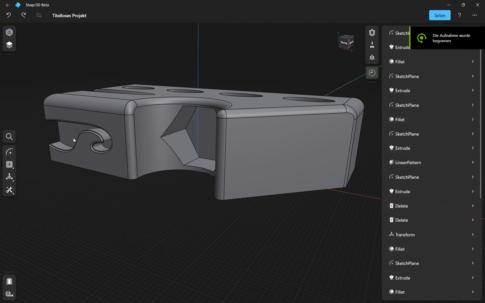

Something similar is happening to me, deleting sketches deletes “unrelated” bodies. There are many more quirks in the file, but just to get the idea.

Why do you think that the sketch is not related to that extrusion?
It IS related in the beginning, but then the body has been quite modified. But what I don’t really expect is, if I want to get rid of an old sketch, that the body disappears with it. Mind you, this is my first experience with a parametric environment and I’m not at all at ease with it, so it is likely that I misinterpret a normal behaviour… which on the other way it is not normal at all with all previous experiences I had with Shapr3D.
If this is normal, then how can I get rid of a sketch without affecting the body? And if this IS normal behaviour I think I would need some kind of a instruction manual to make me orient myself in this new parametric environment. Even if I wouldn’t use the parametric side of Shapr, nonetheless I sure have to be knowledgeable about it!
I have never needed such guide before on Shapr3D, even if I did recur quite often to the online help and the forum to be able to better use some tools… but this is kind of different, it is NOT just a tool, influences deply the whole environment.
What I feel most important, If this is normal, then at present I’m not able to understand if those behaviours are a bug or not :smirk:
Got it! So this is how history based modeling works. A geometry is defined by a sequence of operations. If you remove any of the operations, the end result will change - just like if you remove a card from the bottom of a house cards, it’d collapse. You can hide the sketch without changing the geometry, but if you delete it, it’ll break the subsequent geometries too.
