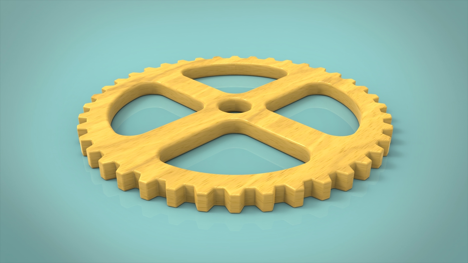

Am thinking of making a model of a wooden clock - lots of wooden cogs! Have been trying different methods for making the cogs. See pic below for the approach that seemed to work best. I made a single segment (top left) and then used the move/rotate tool (top right) setting the pivot point to the middle and setting copy to yes. After copying enough segments to make a quarter of the cog, I joined them together and then copied that segment to make the full cog. The advantage of doing it this way was that I did not have to fillet lots of edges. Holes cut in the cog using subtract tool. Has anyone else found other ways of making cogs? Would be interested to hear. Best wishes. Andy
Wow, that’s actually a really smart approach.
Just rendered the cog in Keyshot 6 - uploaded it from Shapr as a high quality stl file - no other changes made other than adding the wood material. It was a pretty big file so if I do go ahead and make the whole clock in Shapr I will have to upload the big cogs like this one at a time! Anyway, I like the way it has rendered! Andy
